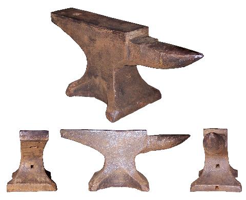

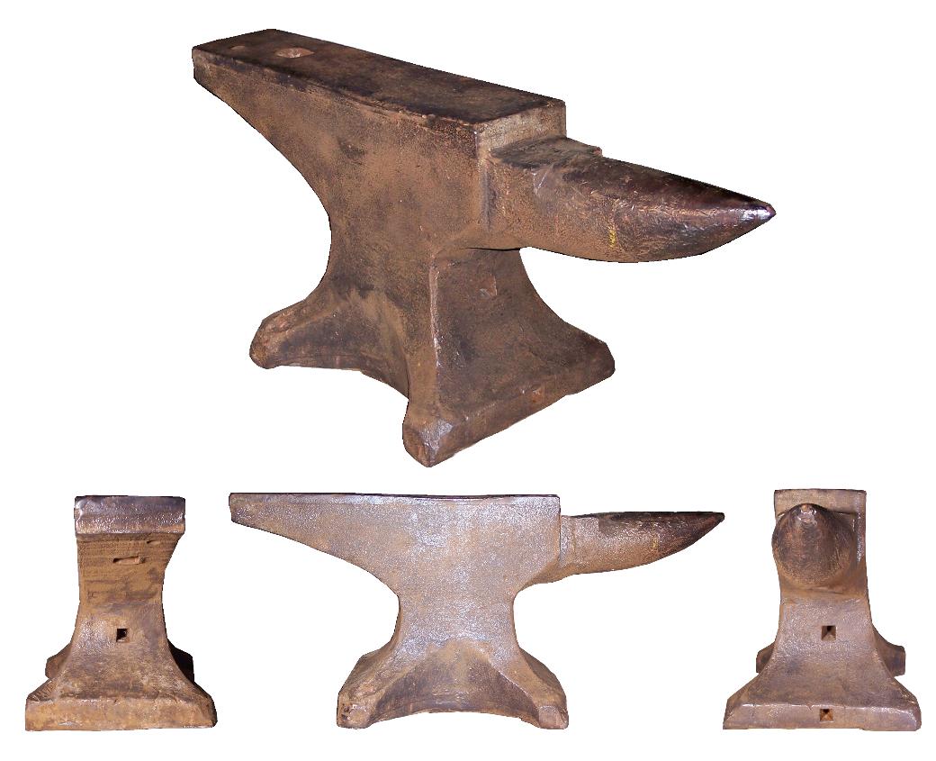

Anvil ID:
Jock and Ken Scharabok;
E-mail with photos of Dad's latest find, 325lb London-style Wrought-Body anvil!
for possible ID.
There are virtually no markins visible at this point in the anvil's life. It's a very usable tool, however.
   - Dave Leppo - Thursday, 10/08/09 08:46:58 EDT
Dave's Dad's anvil. It was either made by one of the lesser known makers OR a second OR its a repair job by one of the major makers that did repairs. The reason I am inclined to say its a repair is the high step and rough horn.
In any case its a good old anvil. So who cares who made it.
   - guru - Thursday, 10/08/09 10:04:10 EDT
Bad Pictures, does the bottom of the heel show visible hammer blows from a powerhammer---it looks like it to me. If so it may be an Arm and Hammer made in Columbus OH as it was common in their anvils not to dress the underneath of the heel.
Good brans if so---can you show us what the bottom of the anvil looks like---the depression in it is distinctive for several anvil makers.
Thomas
   Thomas P - Thursday, 10/08/09 10:54:43 EDT

Dave's anvil - The handling hole in the front foot is a Peter Wright feature, but from the pictures I can't tell if it has the flats on the edges of the feet, typical of the later Peter Wrights.
   - Bernard Tappel - Thursday, 10/08/09 11:30:13 EDT
The bottom is flat with a large square handling hole. Underside of heel shows machine forging marks but is fairly smooth. Weld seams throughout the body indicate piecing together from scrap. Corrosion on one side shows it is definitely wrought iron with steel face.
   - guru - Thursday, 10/08/09 11:36:10 EDT

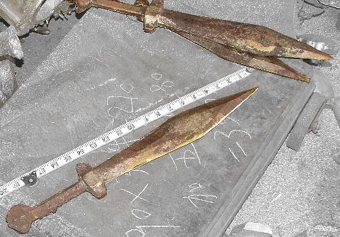

Thomas P, or anyone else with a learned opinion, I was watching the movie "300" again last night.
What do you think about the actuale utillity of the "Sparten" short sword? It is an intreiging design and rather eye catching but, I wonder about the balance and the endurance of a blade form like that.
I think an actuale working blade would be quite unweildy and very hard on the user. Sure would be a neat project to try though...
   - merl - Thursday, 10/08/09 12:05:22 EDT

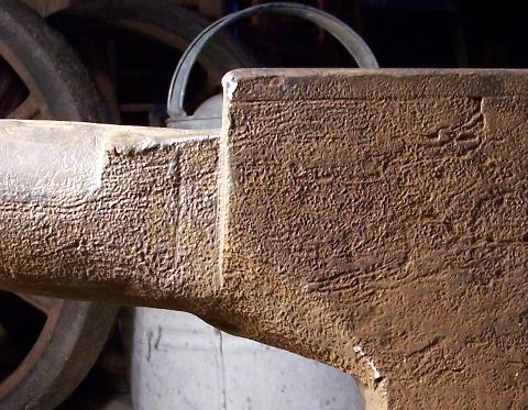

Nope, its not a PW, no flats. PW's, besides had very graceful lines.
Note that the group image is linked to a high res version.
The detail above also shows where the table has been dressed down. Normally the step is created by the addition of the face.
   - guru - Thursday, 10/08/09 12:21:43 EDT
Merl,
I also looked at the Spartan swords very carefully and to me they looked like long bowie knives. I looked online to see if there were real Spartan swords found by archeologists. I saw the documentary about the 300 Spartans and the movie was mostly true except for some hollywood fill ins to spice it up. 300 Spartans did kill over 20,000 Persian soldiers in a two day battle !! It seems impossible, but the Spartans were trained to be warriors from the age of 7 years old. They were trained to fight as a unit and had bronze shields while the Persians were made of wicker.
   Mike T. - Thursday, 10/08/09 14:09:07 EDT
Mike T,
I hate to refer to a movie for any kind of accurate depiction of an actual event but, it's true that the movie was based on a comic book depiction of the actual battle and, has more than just a grain of truth to it.
Accoring to the companion dvd, the styleized fighting in the battle scenes was created from a combination of martial arts, and filming requirements.
I'm sure the weapons were also created to meet the needs of the film but, I can't help wondering how that particular blade would perform.
I don't have any expeirience with any kind of sword but, I do have more than a little practical expeirience with a standard US issue machete so, I look at the blade from "300" and it steems that other than being much heavier than a US machete and a bit longer, it seems like it would work much the same way...?
I have a pretty good grip and strong wrists and arms but, the "300" sword looks like a wrist breaker to me.
   - merl - Thursday, 10/08/09 18:51:54 EDT
Howdy Guru
The anvil looks like an American Wrought Brooklyn NY. I know some early ones had the 4th handling hole and the shape this on has to the foot corners. They had a face plate also, but this could be a repair as you mention. I have seen Americans' with a large step to the table. All of this is just a guess. What do you think?
   - Time Keeper - Thursday, 10/08/09 19:02:55 EDT
Mystery anvil:
Guru, doesn't the horn on that anvil look like it is way too small, like it was put on to replace one that had been broken off and lost?
The horn on my H-B is nearly as long as the top face and as wide as the body.
As you point out, this one was made from a build up of wrought iron scrap so maybe this was all the maker had left for the horn or maybe it was planned out this way.
   - merl - Thursday, 10/08/09 19:04:27 EDT
The battered horn and corners of the feet are why it had the look of a repair job. There is a jog under the horn that looks like it was a support point while being re-forged. You do not see this factory standard anvils.
On the other hand. A friend of mine has a collection of "Colonial" anvils and most are the most butt ugly things you have ever seen. Richard Postman has identified over 250 manufacturers of anvils in England for his new book. The fact that there were so many and that not ALL made really pretty anvils leaves the one above open to be a lesser known manufacturer from England.
As hand made products requiring a teem of workers to produce it would take a lot practice, IE high production levels, to get really good at making an anvil with clean lines. Anyone that saw the face welding operation at Quadstate would agree that it is not an easy task.
My theory is that the big makers in England trained workers that could do a great job of making anvils and many of them left to work for others OR to setup their own shop. But without the volume of work from the huge export market served by a very few they could not keep the level of skilled workers the big makers had. So quality suffered. This is REALLY tough forging, to work with a teem, by hand, to produce a product with a difficult shape and well known lines. Keeping smooth lines and a specific style is the hard part.
   - guru - Thursday, 10/08/09 20:21:12 EDT

On the anvil subject, I agree with the alpha guru. Compared to a cleanly made anvil like a PW, this one looks like it was cob-jobbed. Has anyone noted that it lists to starboard?
   Frank Turley - Thursday, 10/08/09 21:29:59 EDT

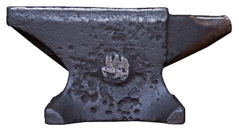

Hi Frank
I saw you in the new Anvil's Ring in your blacksmith school shop. You had your back turned...grin.
Frank, I lists to the left. Since the anvil lists to the right we would balance each other out. If it is up for donation I would give a rebuilt rough anvil a good home...LOL.
I think it is a nice anvil even though a little tough looking. I would call it a Hillbilly Wright and just use it. :)
   - Time Keeper - Thursday, 10/08/09 23:34:33 EDT

"The Slanted Anvil" now there is a great name for a pub!!
Frank, I saw the way that anvil leaned so badly I figured it must have been intentional!
   - merl - Friday, 10/09/09 00:04:03 EDT
i'd say with the spartan sword, it was created more for thrusting and hacking, over slashing and smashing, Hence the big sheilds that when in formation (50-75 men) would cover your partner in an overlapped style, there would be not much room for free swings and crushing blows(thrusts thru gaps in sheilds would be my bet), i have also read text about spartin solders in raiding party's maybe 5-10, that would be sent to neibouring towns and villages for defence, i suppose then the "Hacking" part of the sword would be used in theise styles of fighting, because of the spartan's hard training and devotion to war, he would usually be put incharge of a group of malitia or city guards in small units, seeing as the small units were usually crudely made in a hurry, chances are they were craftsmen,with minimum training and not soldiers, so their weapons would change. fighting in a solid line sheild to sheild would not be an option, some malitia might not even own a sheild,... SPEAR! anyways go to a history site!
   AdamEverAlert - Friday, 10/09/09 00:06:35 EDT

"The Slanted Anvil" I LIKE that!
Merl, Can we use that for the name of our new chat?
   - guru - Friday, 10/09/09 00:22:11 EDT

Thanks to all for the Anvil comments. I haven’t noticed the right-leaning, and have seen it in person twice, once to take the photos, for which I used two clamp-lights and took multiple shots of each side and bottom-front & rear, stabilizing the camera on a stool. I believe that the anvil was made in three pieces: Base, upper Body, & face; this based on the patterns visible in the wrought body and weld line across the waste (said pieces WERE forge-welded from smaller pieces of WI). The whole top-plate weld line is visible, and there’s even a small void in the wrought directly below the face (visible upper right in Guru’s 10/08/09 11:36:10 EDT post). I tapped the face all over, and there are no dead spots that I can feel.
BTW, I have a PW and a Fisher that’s much uglier (but I love it dearly). Dad bought this anvil cheap after making repeated inquiries at the local flee-market. It was in a basement, and now it’s in the BS continuum, and will eventually see use. I don’t need it (I want it).
It’s not for sale, though.
   Dave Leppo - Friday, 10/09/09 07:03:32 EDT
"The Slanted Anvil"
Yes Guru, Please do!
A great name like that should be put to good use...
   - merl - Friday, 10/09/09 09:02:12 EDT
Yeah, we had it setup to be Slack-Tub Pub II but that just didn't flow. . . When we launch the new high tech one the old one will continue on autopilot as it has for years. Amazingly it is running on the very FIRST internet chat program written.
   - guru - Friday, 10/09/09 10:15:41 EDT
Yeah, ya gotta' watch those right wing anvils. . .

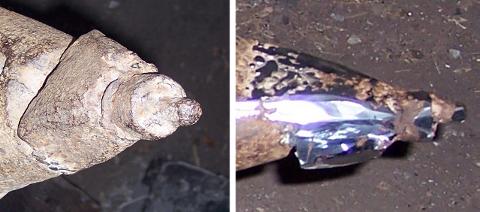

Old Fisher anvil
Dave's old fisher is an early Fisher classic. It had a really primitive repair (below) that he tried to reinforce with some welding. . . It broke off and he found it better to just use as-is. The heavy pitting in the side is a combination of corrosion and casting defects.
Old Fisher anvil
Broken heels and horns are common, especially on Fishers. Primitive repairs are almost as common and often just as comical (or sad, depending on your outlook).
   - guru - Friday, 10/09/09 10:15:50 EDT
Welding not by me - as purchased
   Dave Leppo - Friday, 10/09/09 10:19:02 EDT
The important thing about these two anvils (the "unidentified" and the Fisher is that both are far from perfect but they are both perfectly usable as-is. AND, they are better than shiny new ASO's. They have both lasted 100 years or more and will last another 100 with regular use.
   - guru - Friday, 10/09/09 12:27:38 EDT

Rough Bronze Sword Castings
Philip in China, thought that some castings he recently had made would add to the discussion on Bronze Swords. These are the rough castings photographed at the foundry.

Guru, are you refering to the Sparten swords from the movie "300"?
I always assumed they were forged from some kind of steel.
There is even a brief shot of a blacksmith working a sword over an anvil.
I had not considerd the historical inaccuracy of the metal type.
I suppose I'll have to do some research into the actual weapons used by the real Spartens.
I was realy most interested in how a blade of that wieght and configuration would handle in practice or battle.
   - merl - Saturday, 10/10/09 23:10:45 EDT
Ah, hard to tell. I'm probably mistaken. The Greeks of this era were still considered a transitional society metallurgicaly I think. Iron ans steel had been introduced for a long time and they may have been using steel swords. But they were still using a lot of bronze for things later cultures would use steel.
As far as anvil and forging scenes the movie industry has almost always been technically wrong on one of more parts of these scenes. Bad technique (bang tsp tap), late anvil types in early eras, wrong forge types. Tools that hadn't been invented. . .

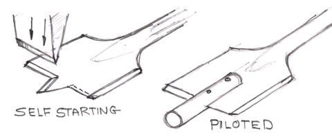

Spade Bits and Spoon Bits: These are two different things and modern bits for use in high speed drills are the cheap and simple spade bit.
A spade bit is just flat with a pilot and the two edges ground opposite directions to make cutting edges. I have hand forged these from round and flat bar, cutting the pilot from the flat with a chisel. By cutting the two sides from opposite sides the edges have a sloped edge as forged and the diamond section of the pilot can be twisted to make a screw. Almost no grinding required.
The problem with these is the high torque especially if they hang up which is common with this type bit. A big one on a powerful 1/2" geared drill will pick you up and do a helicopter with you OR break your arm if you don't let go.
The big problem is drilling hole in the end grain of stumps. The common method was to heat an iron and burn a hole. If you need a good fit you burned the hole undersized then trimmed it with a gouge. Alternately you can make a rough hole and use filler such as auto-body putty.
To make a 3" hole I would probably drill a bunch of small holes, say 1/2 to 3/4" then saw and chisel out the remainder. You might still need to burn out the bottom if its deep.
I have large diameter modern bits for wood that are 2-1/2 or 3" and a 1/2" Milwaukee drill to use them with. They are scary to use and the number one thing I do is be prepared to let go and get out of the way. Even with the long 3/4" pipe handles that screw into the body of this heavy duty drill it can get away from TWO people. . .
AND. . if you don't already have the perfect stump, you can laminate one from framing lumber with the hole sawed out (for square) or carved into two of the 1-1/2" pieces to make a 3" hole. . .
   - guru - Monday, 10/12/09 11:24:55 EDT

Two types of spade drills
Two Types of Spade Drills
These bits are fairly easy to make. The piloted bit requires making a slot in the pilot and pining or riveting it on. The piloted bit will hang less but requires drilling a pilot hole first.
   - guru - Monday, 10/12/09 12:12:52 EDT

Dave's dad's anvil - I worked on an anvil once with that much of a drop down to the cutting table. It was a Hay Budden, I believe, a pretty good sized one.
   - Stormcrow - Tuesday, 10/13/09 21:25:13 EDT
In the Old Millstone Museum collection several anvils have the high step. The Peter Wright and one Hay-Budden are obviously modifications or custom. The PW has a sloped step to make the step higher (common mod on repairs) and the Hay-Budden has a completely reshaped horn which may or may not have been a factory mod. Since these were the anvils owned by the last full time operator of the shop one can assume that he preferred a high step and had all his anvils that way.
The subject anvil (posted on the 8th) has a ground down (sloped) shelf which creates a high step. This is done for several reasons. Most are to create a step where little remains from machining the face (a ruined anvil), others to dress deep chisel marks and once in a rare while to create a higher step.
   - guru - Tuesday, 10/13/09 22:10:12 EDT
I have two Trentons with deep steps, both forged that way. I liked them because you could use them as vee-blocks along with the cross peen in order to start, say, a rolled socket. At one of Francis Whitaker'S workshops, he said that he had arc welded over the chisel marks on one old anvil with mild steel rod. The table was then sanded smooth. He claimed that if you're an ornamental iron smith, that you would not use the table for cold cutting, EVER.
   Frank Turley - Wednesday, 10/14/09 09:28:36 EDT

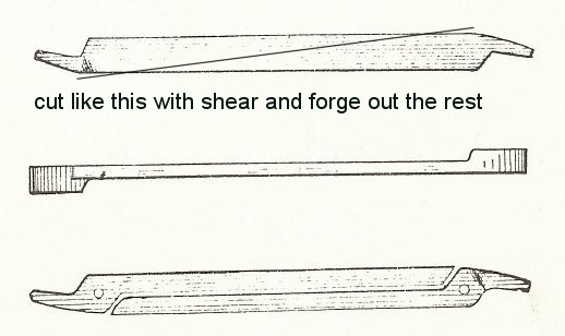

Here is a drawing from MT Richardson's Practical Blacksmithing that Grant sent in. This is what he was thinking about shearing to make tong making easier. I'm not sure the chiseling method at the bottom is easier than drawing out the stock.
A combination of the two might be the best if you have the shear. Chisel the end notches as in the bottom drawing, bend the jaw sections out of the way, then shear the long center cut.
Hmmmmmm a fine flame or plasma cut . . . A short tracer cut?
   - guru - Wednesday, 10/14/09 21:24:08 EDT

Well, I think I'd shear them as shown and then just cut the pointy ends off. Get's you a lot closer to to the finish and it would be quick and easy.
If you have a power hammer then chiseling would not make sense, you could draw the reins out in less time.
   - grant - Thursday, 10/15/09 13:10:08 EDT
(tongs) When sheared I like the triangular taper blending into the joint. Very strong. Most of the hand forging would be to draw this area out a little (but not too much).
Drawing all that out is a one heat job on a power hammer after forming the jaws.
   - guru - Thursday, 10/15/09 14:12:50 EDT

Grants Shear Suggestion:
Grant Sarver Press Shear
This is Grant's idea for a self guiding shear to use on a flypress or other type press. It is primarily a bolt together design so that it can be carefully fitted together.
Depending on the size of the press it could be made of flat stock anywhere from 1/2" to 1". I would make the blades out of the best steel I could afford in flats but for hot work it could be as economical as AISI 4140 or 4150. With care it COULD be welded together. . .
Trim you hot parts in this rather than endangering your Beverly!
   - guru - Friday, 10/16/09 18:52:03 EDT

Shear Blade Option
Press Shear Option
The blade, which also acts as the guide for the shear is a simple plate with a slot milled or otherwise cut in it. My idea was to run a 90°-V milling cutter through the same slot to narrow the cutting land and provide angled throat clearance. Optionally you could just plunge cut a funnel shape at the back of the groove.
This gives you a little advantage at the back of the blade so that (hot) metal could make the turn out of the shear. This would be needed for long cuts such as suggested in the tong making drawing posted earlier.
While the shear could be made of fairly light material the heavier the parts the closer the blades will stay and the cleaner the cut.
   - guru - Friday, 10/16/09 20:46:40 EDT
