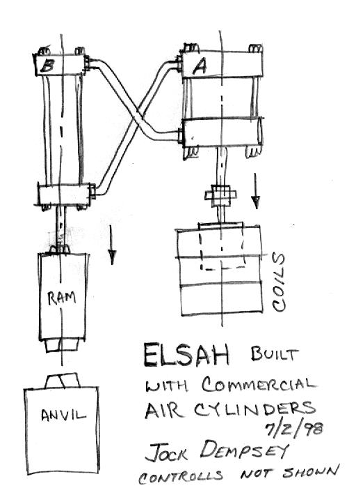

Power hammer: Howdy, I'm building a power hammer and i want it to be unique in concept but functional. I plan to achieve this by using linear induction to hoist and drive the hammer. any comments? you heard it here first Dustin "Herz Aus Stein" Schexnayder |
Dustin "Herz Aus Stein" Schexnayder - Tuesday, 06/26/01 06:40:16 GMT |

Power hammer: Heart of stone, the power company is going to love you! Neat idea, hope it works. |
Alan-L - Tuesday, 06/26/01 14:25:30 GMT |

Electromagnetic hammer: Heart of Stone, Nope, you didn't here it here first. I posted a design 3 years ago based on discussions 4 years ago, based on private (pre internet) discussions 20 years ago. The problem IS that the dies will become magnetic picking up the work and scale will stick to them making a huge mess. There is also a high probability of magnetising the work too. To isolate the magnet core from the dies an aluminium block can be used but then you need to do some VERY careful engineering and use the highest strength aluminium available (7075-T6 ?). Even then it may not be strong enough. Bronze can be used but that greatly increases the non-magnetic mass as bronze is more dense than steel. As you can see the problems are not just with the electro magnetics. I solved some of the problems with a magneticaly actuated cylinders coupling to the ram. This solves many problems but requires a lot of expensive R&D as there is much more to it than this simple diagram. In production (and operation) the hammer would be very efficient but the development costs would be in the hundreds of thousands of dollars. Alan, HP is HP. Electric motors are nothing more than a circular magnetic circuit instead of a straight line. And both are much more efficient than compressing air. ELSAH |
- guru - Tuesday, 06/26/01 16:07:52 GMT |

EMF hammer rambling: Jock: I am not even close to building a power hammer yet but an EMF hammer is where my dreams tend to take me. It seems that the benefits might be an infinite controlability as well as a small footprint. Opinion? I am assuming there would need to be a large capacitance to run it, based on other types of electrical motors. I haven't even gone so far as to do any initial calcs yet. Isolating with bronze sounds like a pretty good way to go for smaller hammers. I had not considered the possibility of building it like your drawing depicts. Alas I have yet to see a power hammer of any persuasion outside of pictures. One thought not completely thunk yet, would magnetism still occur when you drive as well as retract with the coil? Seems that the reversing flow would keep the iron scrambled. Am I looking at that right? Physics was a while ago and I've had a lot of thoughts since. One other posibility while I muse is using resonance to drive a spring hammer perhaps in conjunction with a solenoid to set the frequency. An thoughts along that line? This is what happens when I get well rested and off early. |
Mills - Tuesday, 06/26/01 23:54:38 GMT |

Conference a blur, EMF: Jet lag didn't help here. . . I have a set of videos Torin made that I owe a bunch of folks copies. . . Mills, The drawing is an idea sketch. The coils are progressive with electronic switching. I figured something like a stepper motor controller. The problems with this device include valving the air to induct fresh air. The air in an air hammer will rapidly overheat and and any lubricant becomes fuel and the cylinder can diesel. In the end a good mechanical hammer like a Fairbanks or a Bradley can't be beat for simplicity, controlability and durability. |
- guru - Friday, 06/29/01 20:35:15 GMT |
